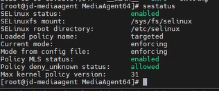

Hello @Muhammad Abdullah
What are the results of running the command [sestatus] on the machine?
If this shows enabled and enforcing it may just be a GUI refresh issue.

Hello @Collin Harper
the status is enabled and enforcing
and i have restarted the commserv services and its still the same old status [Disabled]
