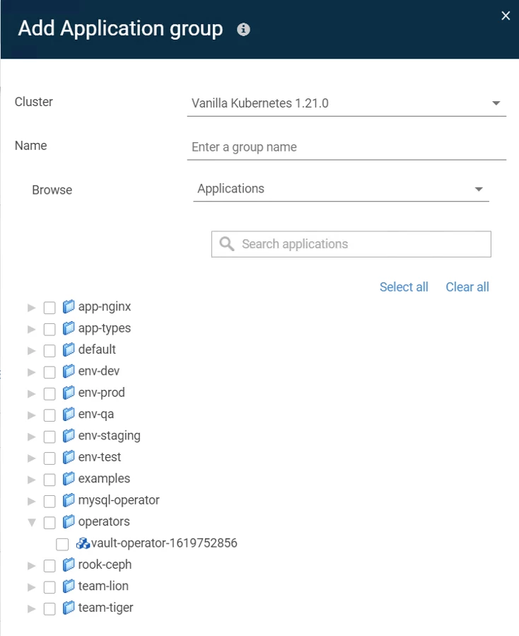

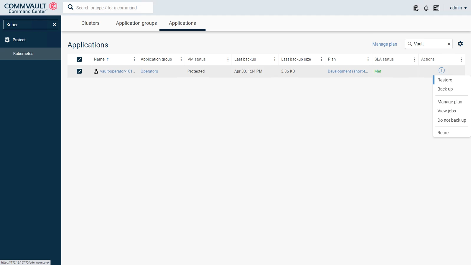

Ok, so let's see if Commvault can see our new operator and protect it...
Commvault can see our new operator, and select it for protection.
In fact, if we check out cluster - we now have a new custom resource definition (CRD) as well - which will be protected when we protect our vault-operator-1619752856 app

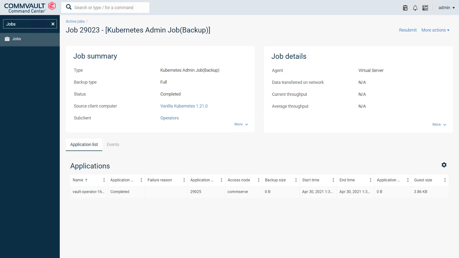

And if we log back in to check our backup status...
Successfully protected.

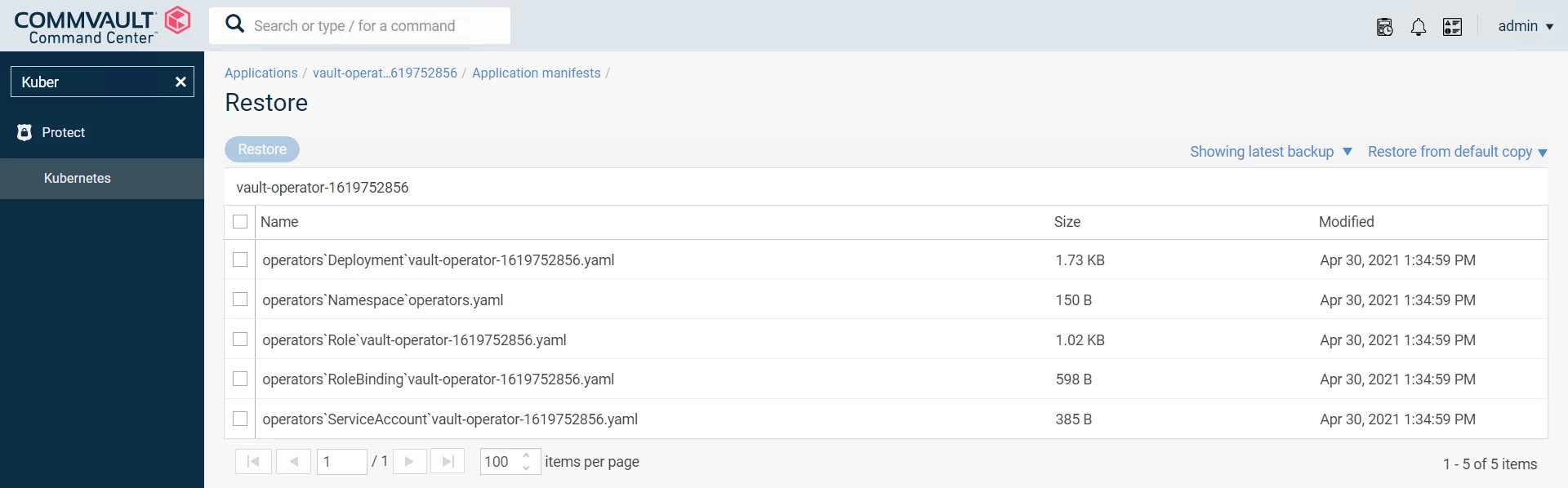

So what actually makes up our Operator backup, let's do a restore now...
We can see that Commvault discovered all the following kubernetes api-resources as related to our vault operator
  • operators`Deployment`vault-operator-1619752856.yaml
  • operators`Namespace`operators.yaml
  • operators`Role`vault-operator-1619752856.yaml
  • operators`RoleBinding`vault-operator-1619752856.yaml
  • operators`ServiceAccount`vault-operator-1619752856.yaml
Now commvault has prefixed each of these YAML manifests (think 'config file') with the text operators, this is because our operator is sitting inside the 'Operators' namespace.
