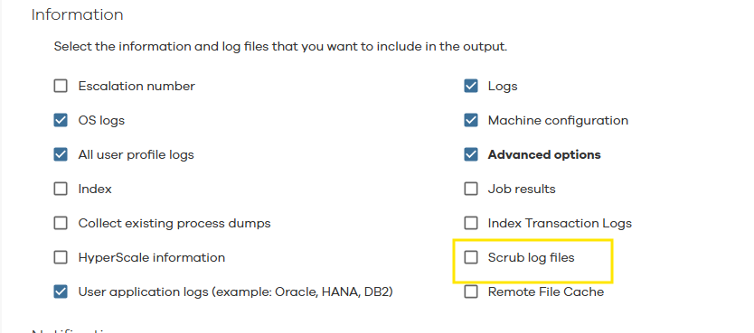

@Erase4ndReuseMedia The "Scrub log files" option is always available in the Send Log Files dialog for your use. However, please note that enabling this option will render the log files largely unusable for Commvault Engineers, making it difficult to troubleshoot issues effectively. It is advisable to use this option with discretion.
Unfortunately, the Scrub Log Files option isn’t very effective.
Forum|alt.badge.img+1
  • Vaulter
  • February 6, 2025
@Erase4ndReuseMedia
Please E-mail me bheemesh@commvault.com the list of entities that are not scrubbed when you used this feature so we can check it out.
