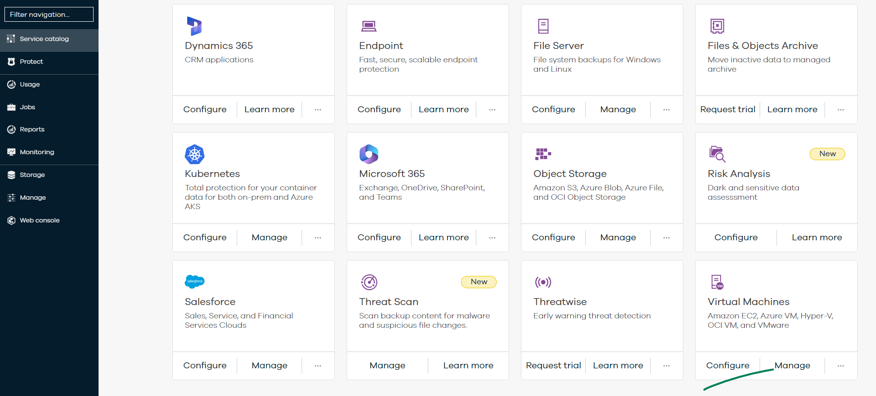

Before pushing the Media agent package, please ensure that the VM seeding package is installed on the VM. Once it is installed, then use the option “Add Software” from Manage>Servers.
