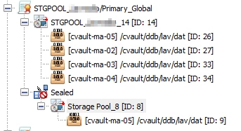

Hi @Eduardo Braga.
Could you help us know if the previous DDB engine was sealed and is this enabled for Macro pruning.
Forum|alt.badge.img+11
  • Author
  • Apprentice
  • Feb 8, 2024 3:04 AM UTC
Hi @Eduardo Braga.

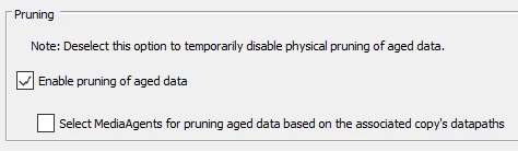

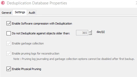

Yes, There is one sealed DDB and the option to physically prune is enabled.
I check every Mount Path of the Disk Library and they permit pruning of aged data. At least, not directly.
The cvault-ma-03 and cvault-ma-04 MA servers don’t have access to any Mount Path.

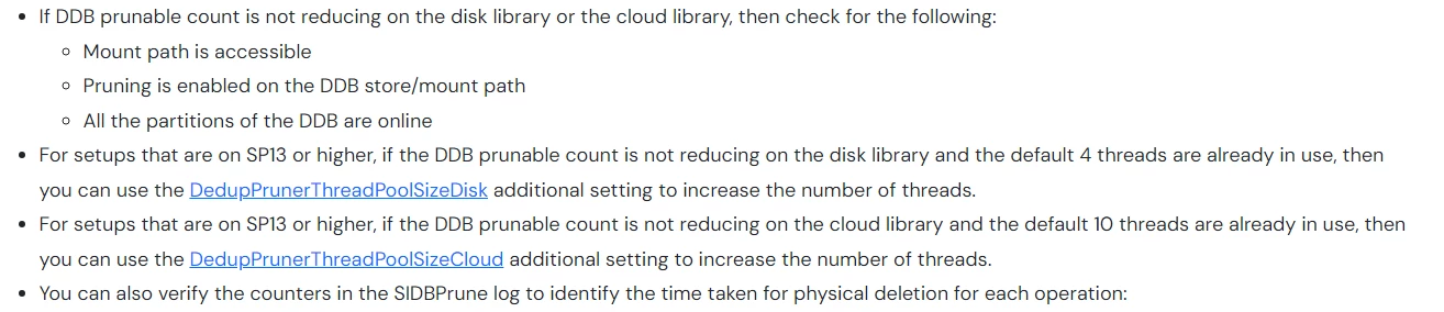

@Eduardo Braga : Is the Prunable block count rising consistently?
There is this KB article you can refer for quick reference.
https://kb.commvault.com/article/53997
 No, It’s steady for days. Almost 26 milions of blocks for days. At least 30 days.
More info: the documentation you mentioned states that “If the CommServe job records to be deleted count is higher and is not reducing, then ensure the following”
In our case, we don't run the data verification job for a long time.
