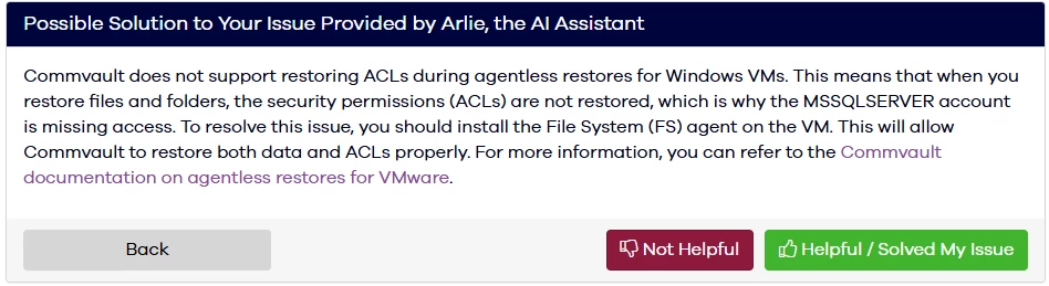

I started to create a ticket about Commvault not properly dealing with the folder security and Arlie the AI Assistant managed to find the solution to my problem.

Ahhh I thought you were already using the agent to perform the recovery. Indeed through an agentless recovery it will never be able to apply permissions as this requires direct interaction with the Windows operating system APIs.

Wait, you’re right. I have a file system backup which meant I would have needed the file system client in order to do the restore. Hmm. I’ve gone through so many starts, stops, and redo attempts on this test restore that it’s no longer clear what works and what doesn’t. I think I’ll have to start a disaster recovery restore test from scratch.
