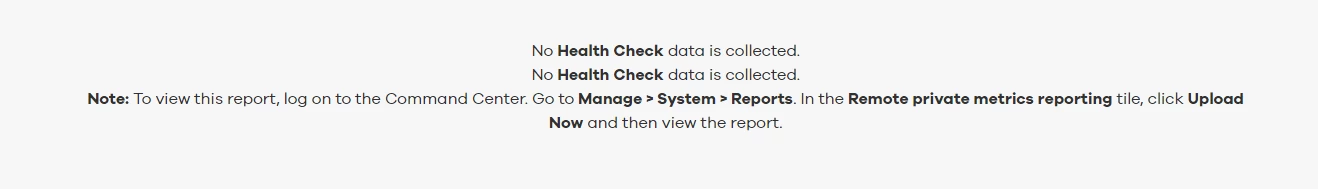

It appears the change may take a while to reflect.
I at least get the status of the Health Report to load
I have actioned the below so will await results.
