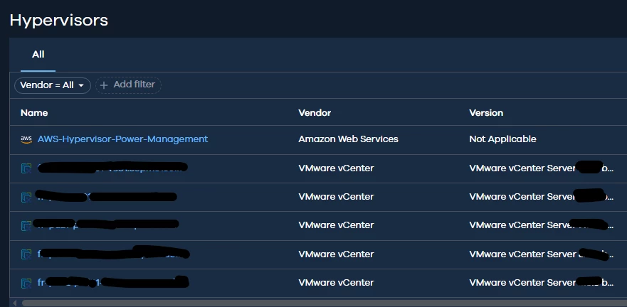

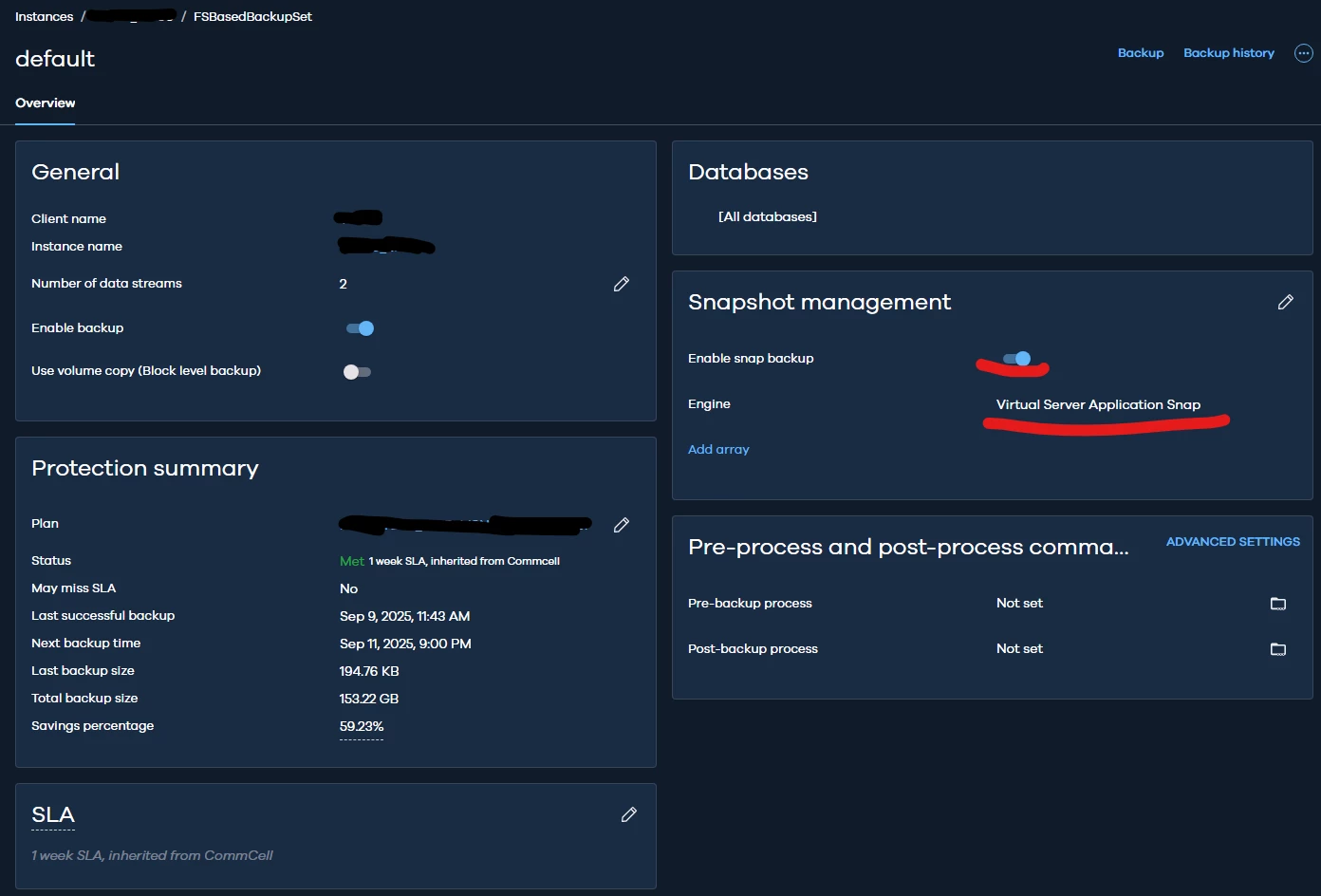

Works well if I enable it here
I have some PosgreSQL VMs  hosted on VMware VXrail
On the VMs there is the PosgreSQL agent installed.
I tried to enable intellisnap but it fails
