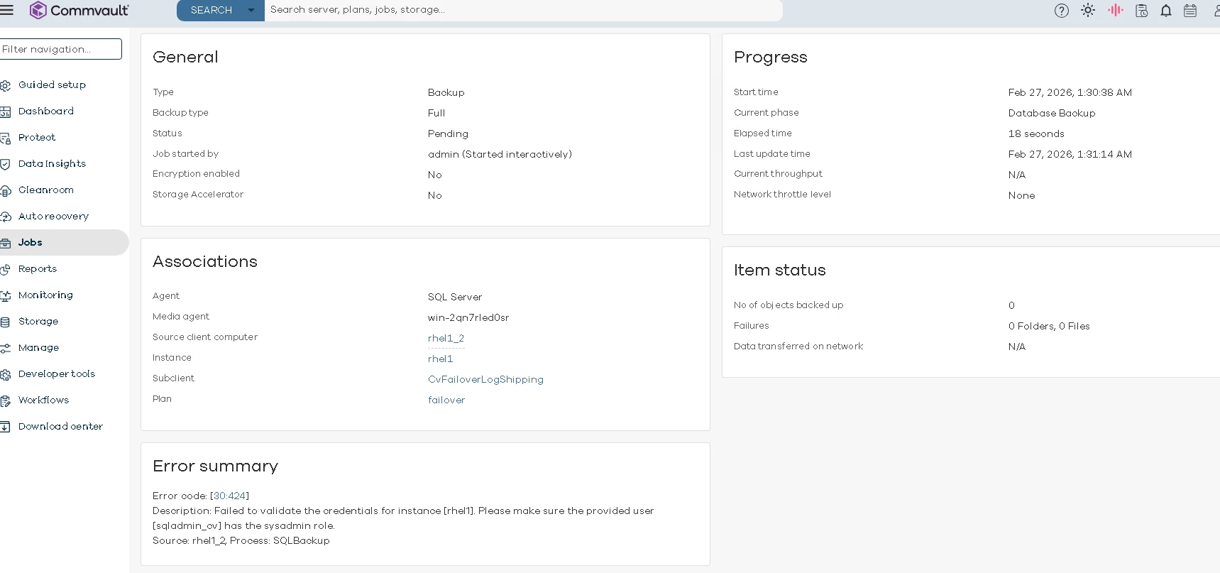

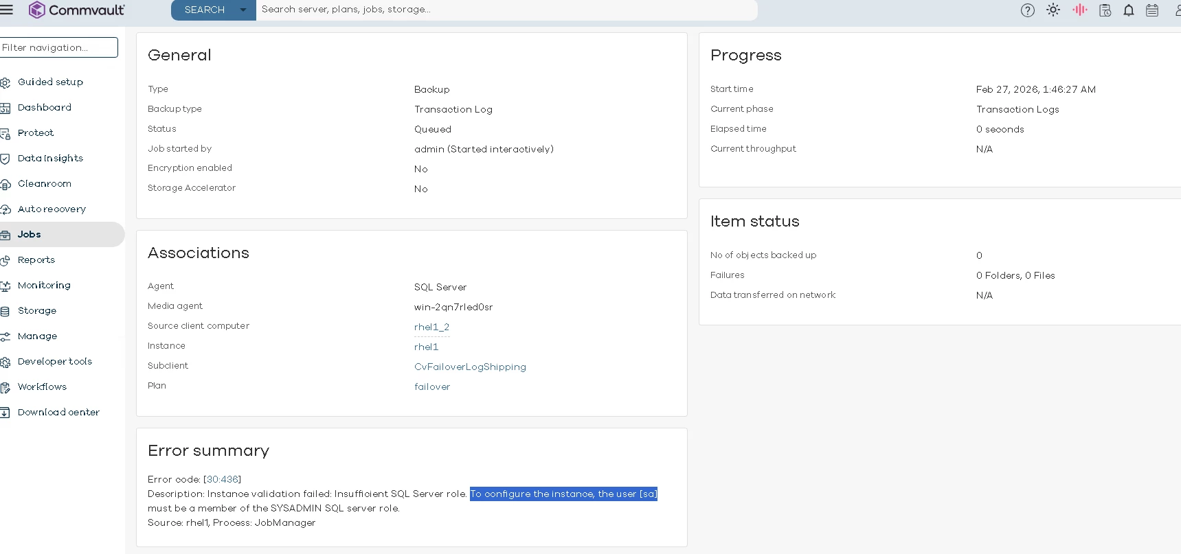

When we attempt to perform the failover, the CvFailoverLogShipping job gets triggered but fails with the following error:
Error code: [30:436]
Description: Instance validation failed: Insufficient SQL Server role. To configure the instance, the user [sqladmin_cv] must be a member of the SYSADMIN SQL server role.

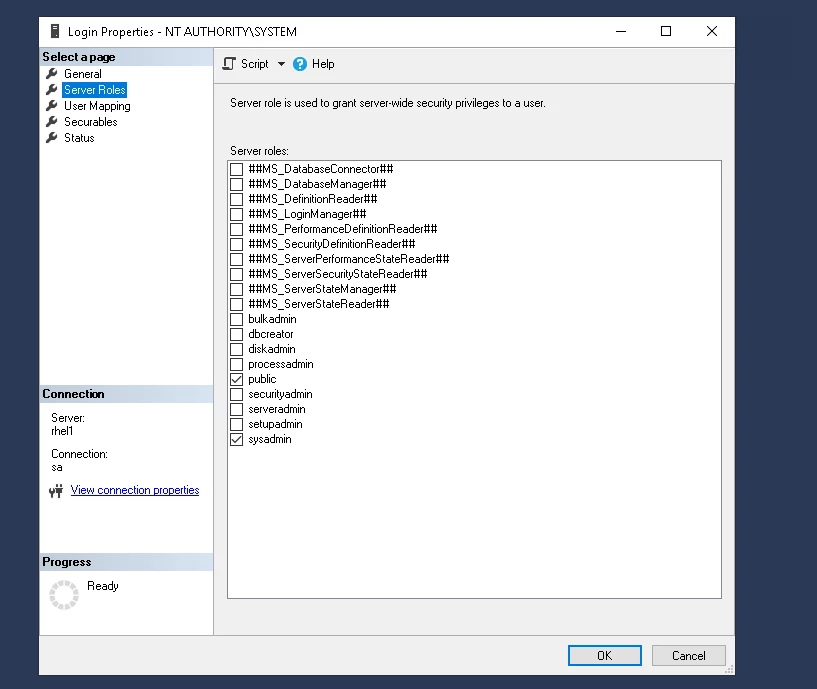

To verify/assigns the sysadmin role to the 'NT AUTHORITY\SYSTEM', please follow the below steps:
1. Open SSMS and connect to the CS Instance.
2. From the Explorer, Expand Security -> Logins -> right-click NT Authority\SYSTEM -> Properties -> Under "Server Roles", ensure that "sysadmin" role is selected for 'NT Authority\SYSTEM', if not check it and Hit on OK.

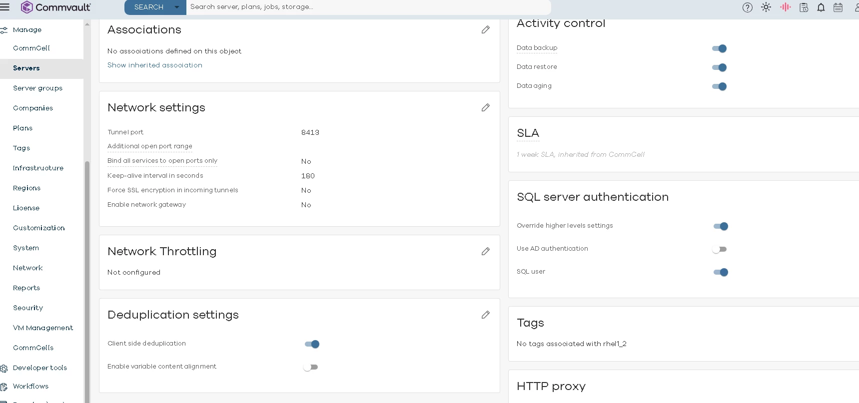

Also, If you would like to use a different account which has the sysadmin roles, you can impersonate that user at the Instance level in the Commcell Console following below steps:
1. In Commcell Console -> Select the Click the Failover Client -> SQL Server -> Right-click on the Instance -> Properties.
2, Under Accounts tab, you can select "Override Higher Levels Settings", select "Impersonate User" and type the user account having sysadmin role on the SQL Instance  and click Ok.

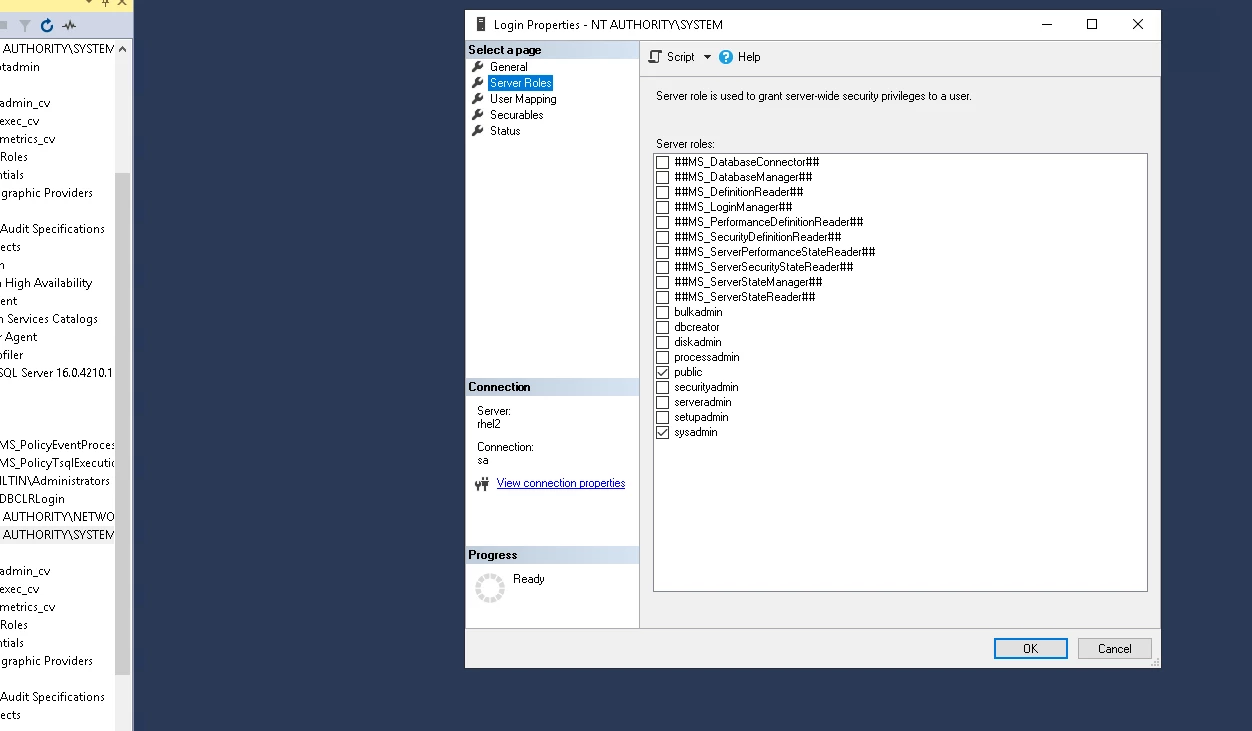

As suggested, we verified the SYSADMIN role assignment for the required accounts.
Findings:
On the primary SQL instance, the required SYSADMIN permission was already assigned.
On the standby instance, the SYSADMIN role was not assigned earlier. We have now added the SYSADMIN role there as well.

Additionally:
We attempted to use impersonation with a different account having SYSADMIN privileges.
Since this is a Linux-based Commvault setup, we are unable to open the traditional CommCell Console.
Therefore, we performed the impersonate sql user from the Commvault Command Center (dashboard).
