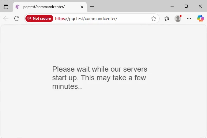

I’m in the process of testing a new deployment and looking to enable Post Quantum Cryptography, building it out in my lab to confirm how it all works and following the process in documentation here: Enabling Post-Quantum Cryptography
Config is an “all in one” with the CS & webserver on the same server on 11.40.10 media. When I have the two additional settings enabled for the CommServe the Command Centre doesn’t start up.
The CommandCentre.log has this entry repeating:
 11396 9 08/06 15:38:53 ### 192.168.1.116   ERROR PlainHttpHelper:getResponse:494 - ******Error code 400 returned for API:[/getOemId]
11396 9 08/06 15:38:53 ### 192.168.1.116 WARN CVAppContext:getOemIdHelper:334 - oemId null or 0, this should be cached already, fetching it again.
11396 9 08/06 15:38:53 ### 192.168.1.116 INFO SettingsService:getOemId:587 - Request /getOemId
When I disable the settings for the CommServe Command Centre loads and the errors aren’t present in the logs (but clients won’t install with the PQC checkbox enabled).
I’m wondering where I’m going wrong.
Best answer by MFasulo
Scott, this was a windows problem with the MaxRequestBytes and MaxFieldLength being set to 30720 decimal instead of hex (we got the documentation updated).
Since they aren’t required for a Linux CS it must be something else.   Check webserver.log or commandcenter.log there should be corresponding errors.   Hit up me if you need help.

Michael, awesome that you are testing this out.    Are you using Windows CS or Linux?   I’m running the same version in my lab so this should work.   Shoot me an email, I’ll compare your setup to mine and lets get you fixed up.  mfasulo@commvault.com

I’m experiencing the same on a Linux CS.  If we find resolution, please share.
Thanks,
Scott

Still not clear to me what the fix was in case you run your CommServe on Linux.
The problem Michael reported is related to a setting that only affects windows (and in this case a windows CS).
Although Scott’s symptom is the same, the underlying problem is different, and I'll need those two logs to troubleshoot.
