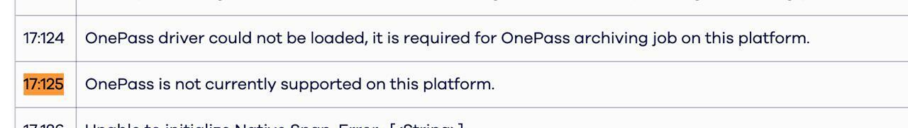

Dear Experts and Gurus,
This is my very 1st post as a CVLT Partner and I know how precious your help can be.
I was the Territory Manager for Africa from Oct 2020 to Oct 2023.
Now Unception CEO, Service & Training Partner for France and French Speaking Africa.
Deploying CV 11.36 at a telco for Call Detail Records archiving.
We could cover many obsolete systems.
For AIX 5 we tried 11.20 and got the attached error message.
We’re still looking for some solution/work around; I decided to share this humble request though.
Looking forward to some help/advice/tip.

 Hello ​@Hicham Marwane
Thanks for the question but i am not 100% sure what you are asking.
Are you attempting to protect a server running AIX 5? If so its worth noting that support for AIX was dropped in 2012.
If you are using 11.36 the oldest version of AIX that is supported is 6.1
https://documentation.commvault.com/2024e/expert/aix_file_system_system_requirements_02.html
Going back in documentation we can see FR11.20 supports AIX 5.2
https://documentation.commvault.com/11.20/aix_file_system_agent_system_requirements_02.html
