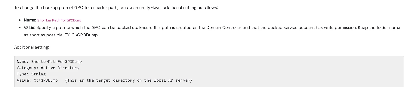

I am trying the workarounds mentioned in the Commvault KBs, registry to allow longer path, and/or folder with short name on C:\ drive.
However, I would still like to know if Commvault tries to add the folder set in the Additional Setting, or if the customer needs to create it?
(We do not have access to our customers’ servers. They set up Commvault agent on their end, and we manage the service on their behalf, but without any access, except for what we can do within Commvault.)

Hello ​@No special characters
You can use this additional key and this can be applied from commcell as well as command center.
Category: Active Directory
Type: String
Value: C:\GPODump (This is the target directory on the local AD server)

Thank you, I am aware. I apologise for not being clear:
When using this Additional Setting, and set the folder value C:\GPODump:
Does the folder need to exist, or will Commvault service account try to create it during the backup process?

Yes, folder needs to be created by the admin otherwise backup will fail (Commvault won’t create that folder). Just found another KB where this is clearly stated https://kb.commvault.com/article/84962
You have to create a folder and make sure the user used has full rights on that folder.
This is also mentioned here: https://kb.commvault.com/article/84962

I have a customer on 11.36.55 with the same issue. The reg entry was on the DC but the folder C:\CVGPO was not created. I created this folder and AD backups ran without errors.
  • Novice
  • Aug 14, 2025 8:33 AM UTC
Hello, I'm experiencing the same issue. Have you found a solution ?
