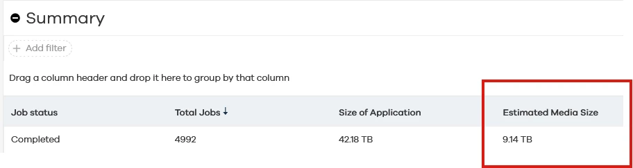

take a look at the Backup job summary report.
The Estimated Media Size x 30 days should give you an idea about the possible savings.
Thanks,
Ralph

Hi ​@SMDQ,
Thanks,
Ralph

Hi ​@Ralph,
Thank you very much for the info. I will give this a go.
Cheers,
