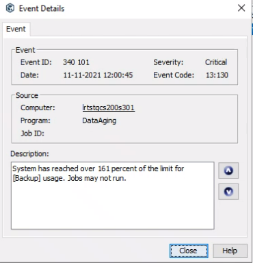

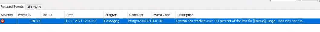

Had  a problems after made a bakup to tape library, total backup job made yesterday 3Tb.
Today i received the message that “system reached over 161”
But the differencial is a backup jon made in Tape Library, is it countable on license (File Library)?

@Fernando Souza
Please run a license summary report and check Capacity, Once the report finishes you should then see what jobs are contributing to the capacity.
