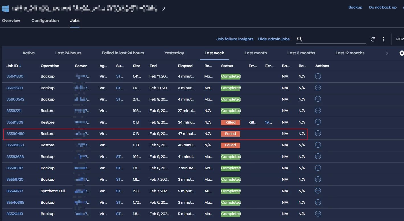

In Command Center → vm detail → jobs section, we see that the job in question has the status of “Failed”:

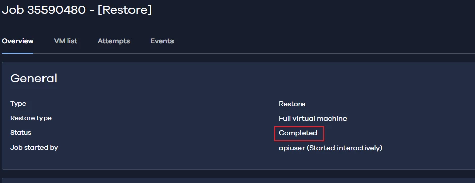

Yet if we go into the job detail page by clicking on the job id, the status becomes “Completed”
