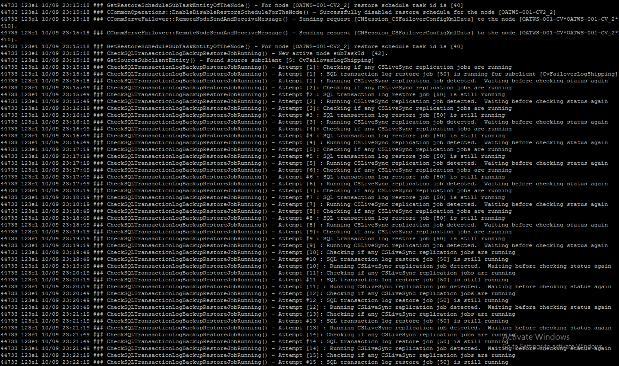

Failed Log from active node when failover [OATWS-001-CV_2]
Failed Log from standby node [OATWS-001-CV2_2]

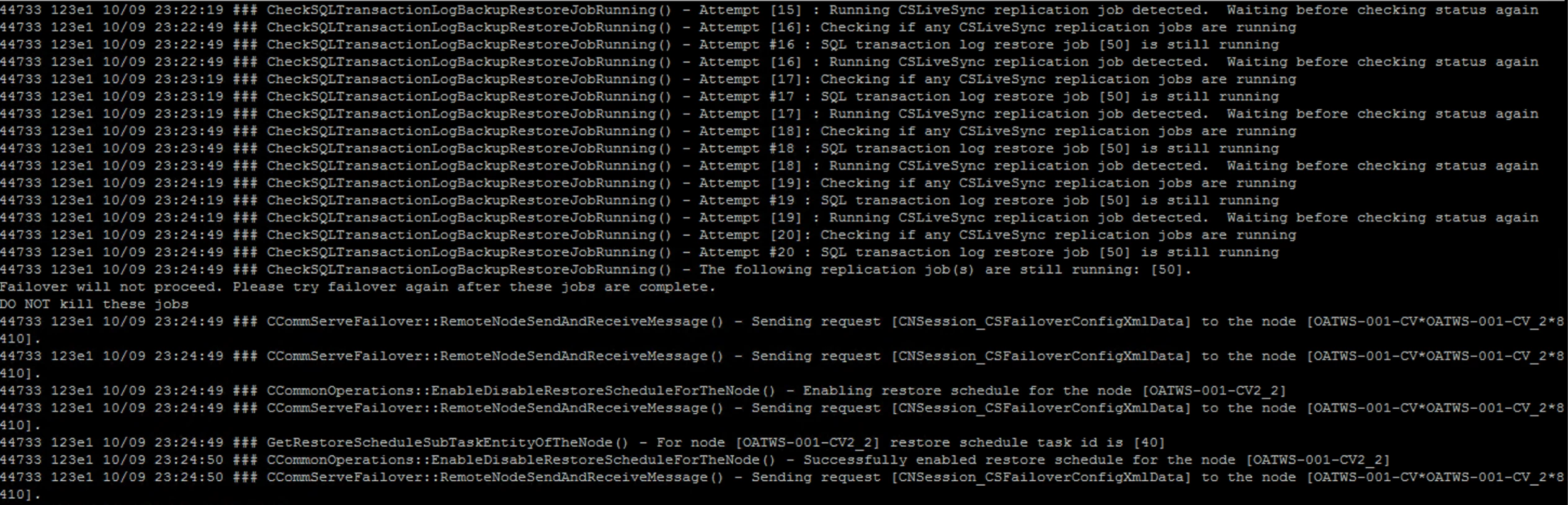

Could you please to help suggestion,  i try to find what is the root cause but still uncertain.
Hi ​@kitty-yip , there is active CS Replication job running with Job ID “50”, check the Console to see if that job is still running, suspended or has any problem, fix it then start new replication and failover

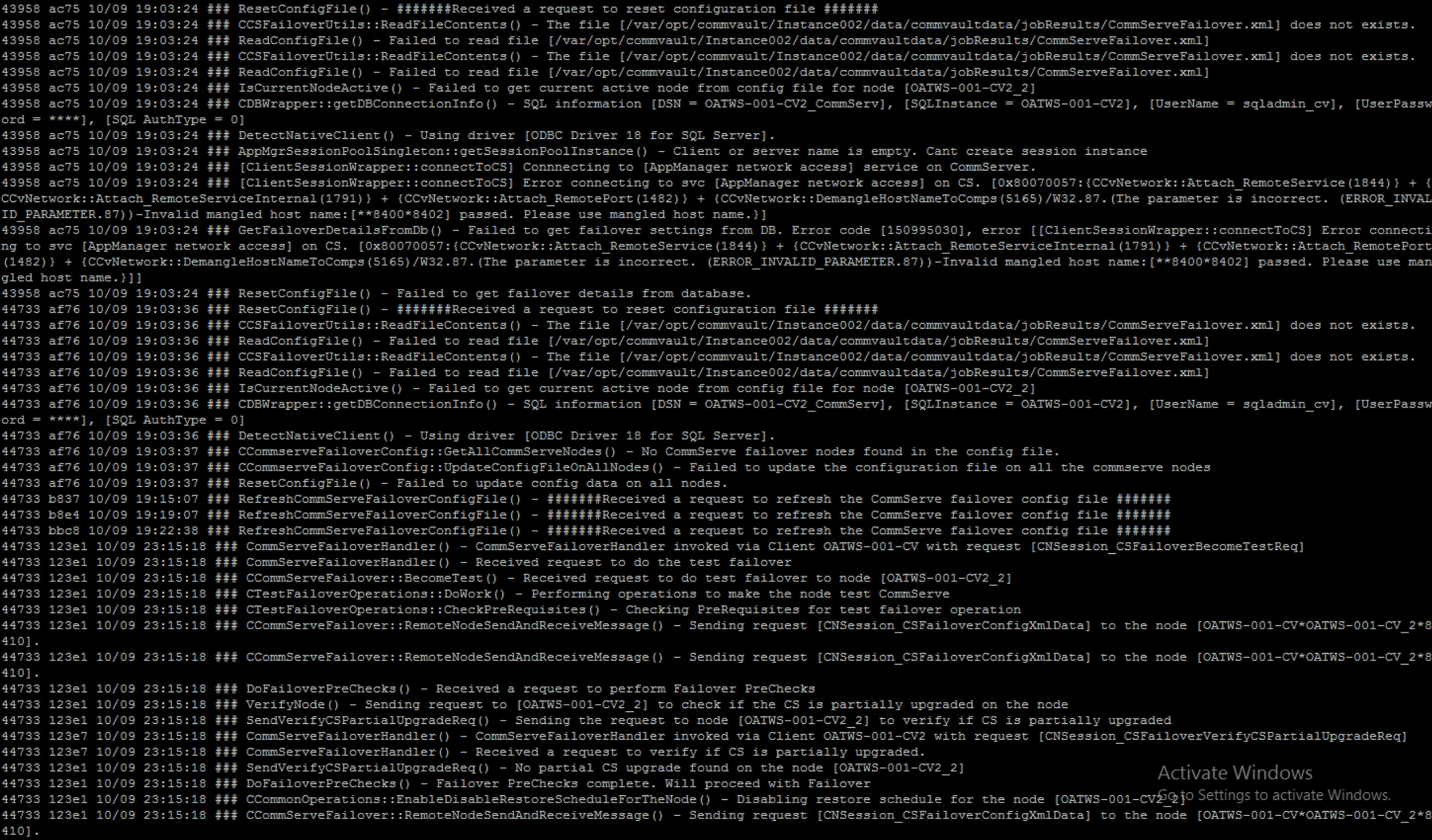

  • Oct 22, 2026 2:18 PM UTC
Found this error on standby server. -->  10/09 19:03:24 ### GetFailoverDetailsFromDb() - Failed to get failover settings from DB. Error code [150995030], error [[ClientSessionWrapper::connectToCS] Error connecting to svc [AppManager network access] on CS. [0x80070057:{CCvNetwork::Attach_RemoteService(1844)} + {CCvNetwork::Attach_RemoteServiceInternal(1791)} + {CCvNetwork::Attach_RemotePort(1482)} + {CCvNetwork::DemangleHostNameToComps(5165)/W32.87.(The parameter is incorrect. (ERROR_INVALID_PARAMETER.87))-Invalid mangled host name:[**8400*8402] passed. Please use mangled host name.}]]

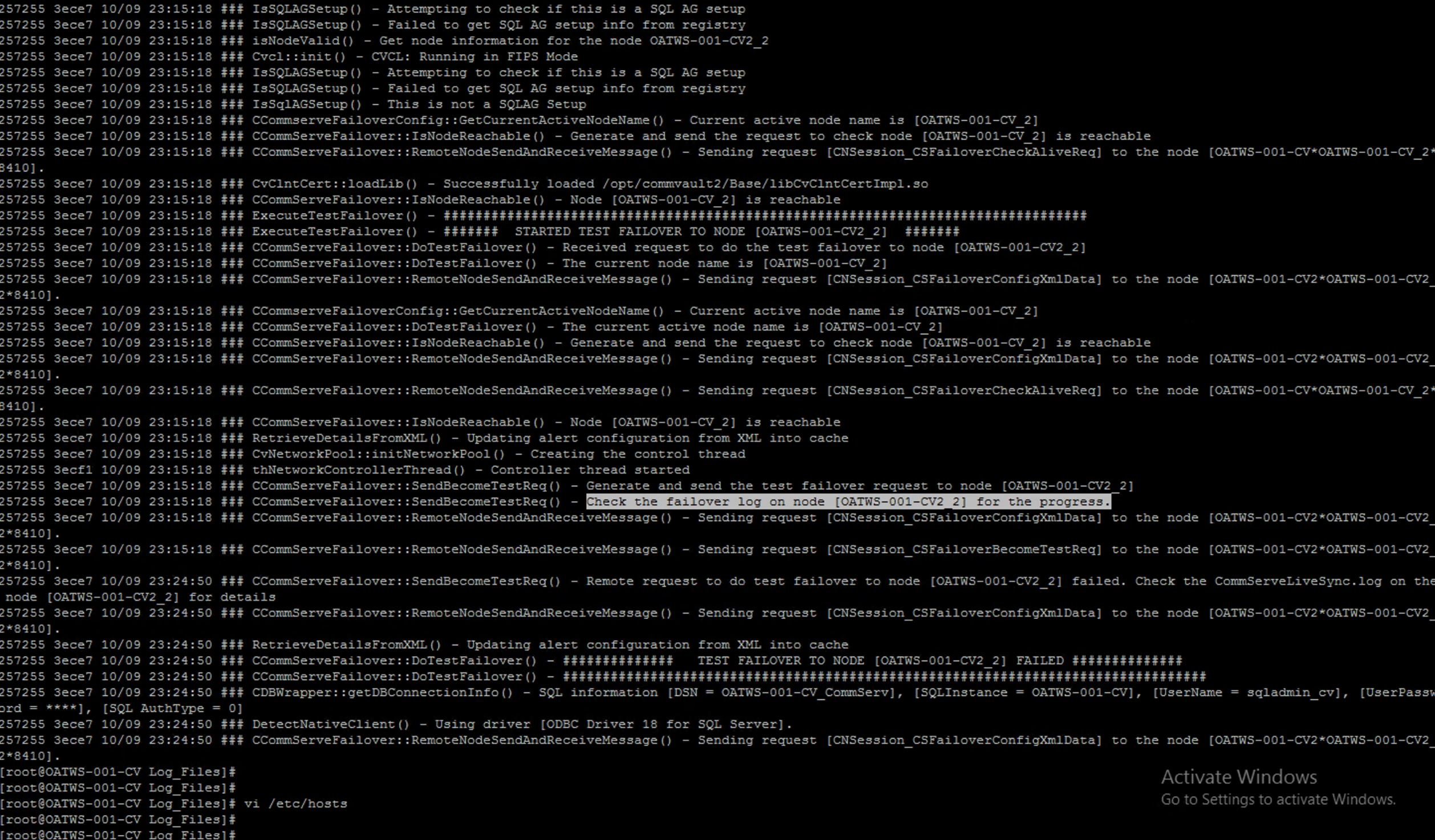

I attach log of Active & Stand by commserve that test ha failed.
