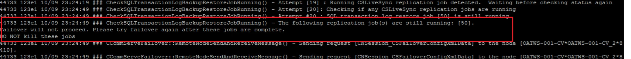

Hi my environment is below detail.
  - Rockey Linux 9
  - Commseve SP44 Hot fix 23
[Active Node] hostname OATWS-001-CV (instance 001) OATWS-001-CV_2 (instance 2)
     - All in one setup.
[Standby Node] hostname OATWS-002-CV (instance 001) OATWS-001-CV2_2 (instance 2)
    - Commserve and failover package installed.
Failed Log from active node when failover [OATWS-001-CV_2]
Failed Log from standby node [OATWS-001-CV2_2]

Could you please to help suggestion,  i try to find what is the root cause but still uncertain.
Hi ​@kitty-yip , there is active CS Replication job running with Job ID “50”, check the Console to see if that job is still running, suspended or has any problem, fix it then start new replication and failover
Thanks,
Abdu
