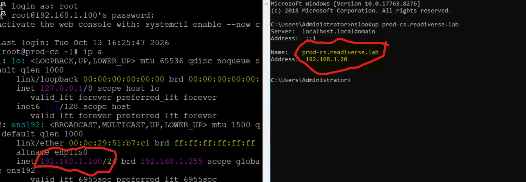

Hey there, guys!
I was on my CCE training, and soon after the deployment of the commcell at the prod-cs, i’ve been trying to reach the console, but the browser simply can not.
Any tip, such as disabling FW?
Looking forward to hear from you guys.
1 reply
  • Novice
  • Oct 13, 2026 9:33 PM UTC
So that you can access it, please use the address 192.168.1.100. As shown in the screenshot, the address for prod-cs is 192.168.1.100, while its declared DNS entry is 10.168.1.20. This is an engineering course, and I believe there will be troubleshooting challenges during the training.
