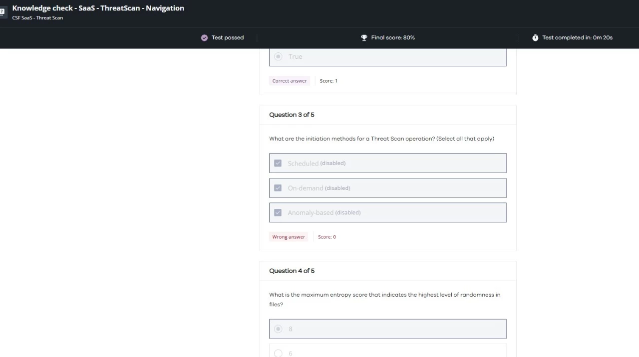

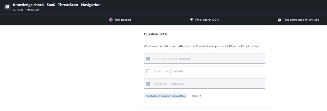

I have completed the course and as I mentioned earlier threat Scan does not support scheduled operations.
I wanted to bring something to your attention. I attempted the assessment twice:
  • In my first attempt i selected the option that says Threat Scan can be scheduled as David noted that was marked incorrect (see screenshot below).
  • In my second attempt i selected the option without scheduling as I mentioned earliere for ​@Nikos.Kyrm  which was marked correct — as supported by both the course material and documentation (screenshots attached).

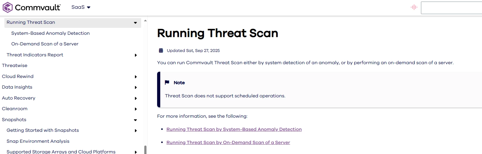

I also reviewed the official documentation updated Sep 27, 2025 which clearly states that Threat Scan cannot be scheduled.
https://documentation.commvault.com/saas/running_threat_scan.html
Could you please confirm this for me ​@Jennifer Kelley  ? I’d like to be certain especially since we have an upcoming project relying on this information.
You know we are an MSP and service company any incorrect information could impact our credibility and trust with clients.
Thank you!

For SaaS, Threat Scan operations cannot be scheduled. As the documentation site has noted, only system detection or an on-demand scan is supported. The answer of the quiz reflects this.
This is not to be confused with Threat Analysis operations specfically where the job runs against backed up content and is therefore running against a schedule.

As Jon stated, the course and our technical documentation are correct in stating that Threat Scan cannot be scheduled. However, this feature is scheduled to be added in an upcoming SaaS version update. Pleaser reach out directly if you have additional questions.
