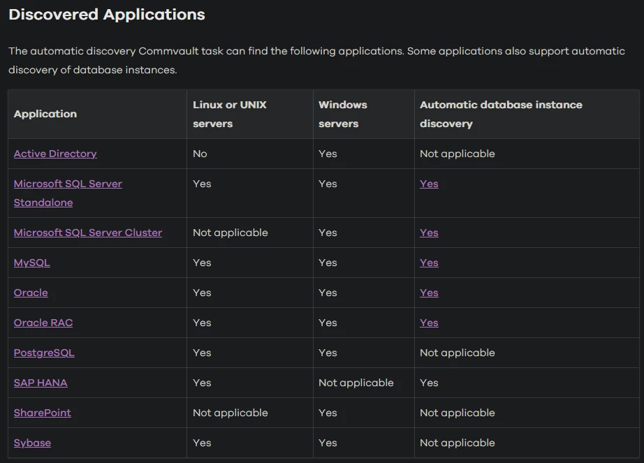

Hi Nadavv, Automatic Discovery is supported for the following applications:
With regards to specific accounts or tagging, this is not yet a supported feature.

Upon reviewing the provided information, it appears that the auto discovery features are primarily tailored for on-premises applications. I would like to confirm:
  • Is it possible to configure auto discovery for cloud-based databases such as Azure SQL Database or Amazon RDS within the Metallic environment?
  • If not currently available, are there plans to support auto discovery for these cloud services in the future?

Hi Nadvv,
We're not currently providing backups for PaaS databases, but backups for VMs and Storage Accounts can be provided best on the tags - so your setup should be covered. The auto-discovery feature shown in the image refers specifically to on-prem or VM-installed databases.
Please note that third-party backups serve more as an additional layer of protection to stay platform agnostic, rather than a primary backup method. For example, Azure’s native SQL backups run every 5 minutes and are geo-redundant by default.

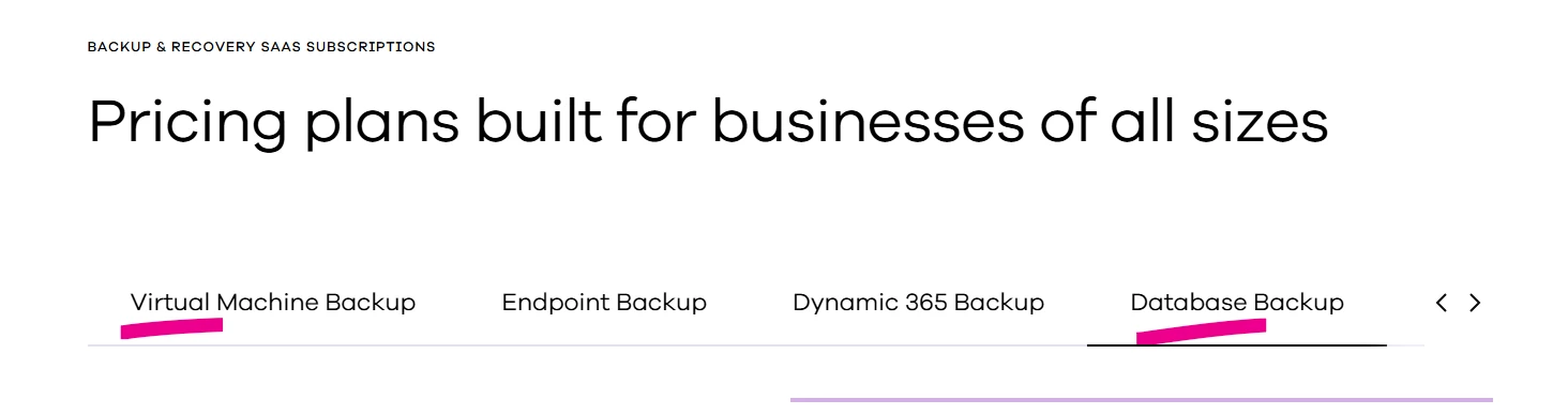

Of course it’s possible, you even linked related documentation (Azure Databases), but there are different licenses for different workloads, so not every customer is using everything. Here are some examples:
  • VM Backup
  • Files & Object Backup (including Storage Accounts)
  • Database backup (including PaaS DB)
  • M365
  • etc.
Here you can see the details - SaaS Pricing | Commvault

Hi Nadavv,
Just to clear any confusion, we don’t protect these PaaS instances via the Automatic Discovery protection method referenced in your post but can explicitly have these setup and configured for backup instead. I believe that it was Lukas is trying to communicate here.
