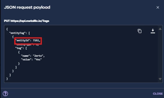

  2. I am trying to add a Tag to a long list of VMs, and the API mentions an EntityID.  When I use the API call to "https://api.metallic.io/V4/VirtualMachines" it gives me a lot of great info but no EntityID.  I tried calling "https://api.metallic.io/V4/VirtualMachines/$vmUUID" to see if that would give an EntityID, but I don’t see an EntityID in the results.  Where can I locate the EntityID?

I was able to find the EntityID, even though it looks like it is technically the clientID.
