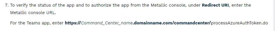

I am trying to follow the instruction from the Metallic Documentation, Register the Azure App for Teams in the Azure Portal (metallic.io)
On Step 7, what value do I key in? Command_Center_name.domainname.com?
Best answer by Ryan Carr
Hi JDiz
Best way to do the configuration is using the Express as its very clean and uses background workflows to complete the process
https://docs.metallic.io/metallic/134742_use_express_configuration_to_create_teams_app.html
To answer your question the URL you can find from the top of your webpage after logging in
you should see M1XX.metallic.io and the secondary numbers are depenent to where your tenant is located.
so the full URL would be
M1XX.metallic.io/commandcenter/processAzureAuthToken.do

Hi JDiz
let me know how you get on
Thanks
Ryan
