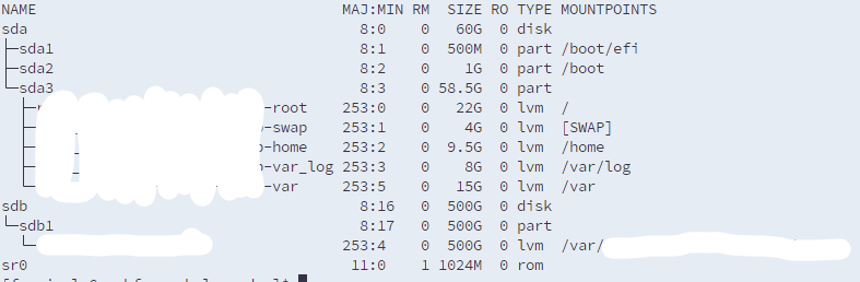

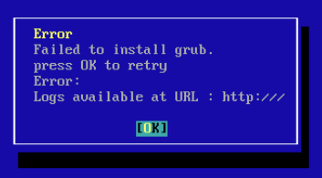

I’m trying to virtualize a 1-touch backed up fileserver and running into a “failed to install grub” error message at the end of the process
this is the disk layout i’m trying to restore
I have the client logs but I don’t know where to look (and also don’t believe it’s safe to upload as-is here)
Any ideas?

This can happen due to a bunch of reasons, and it's not always straightforward to isolate. Here are a few common ones to check:
  • Source system is UEFI, but the target is BIOS (or vice versa)
  • Wrong or mismatched ISO version for the restore
  • Incorrect Media Agent name entered during recovery
  • Network issues between client, MA, or CommServe during restore
  • Missing or incomplete /boot or /boot/efi partitions in the backup
  • Firmware or hardware-level incompatibilities, especially after updates
Since this needs a deeper look into logs and setup specifics, best next step is to open a support case. Just make sure you include the ISO version used, boot mode, system details, and recovery method (in-place or out-of-place).
