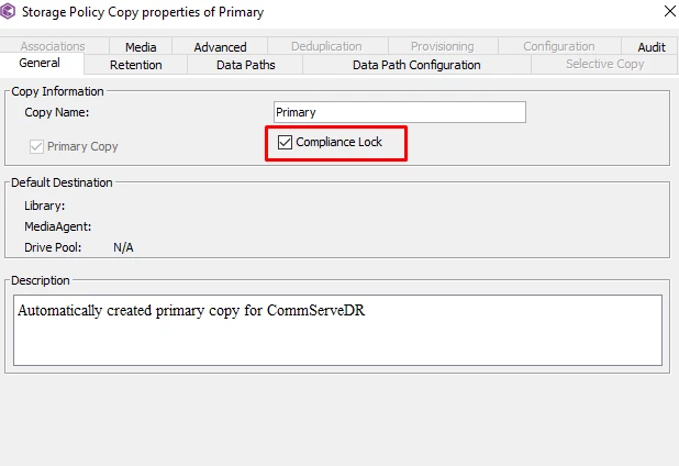

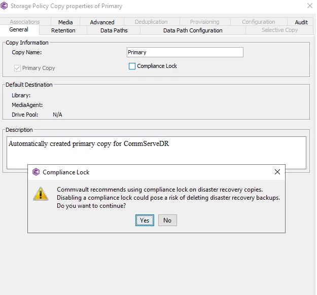

Hello Commvault Community,
Do you have any news about problems using the AllowUnsetComplianceLockOnDRCopy key for SP36?
The ability to remove the Compliance Lock for the Primary copy within the CommServeDR StoragePolicy works for lower (SP32 for example) and higher (SP40 for example) Service Packs.
I currently have a case where this key doesn't work in three lab environments (SP36).
It's added at the global level for the entire environment (CommCell level) and is set to true:
When I go to the CommServeDR policy, the option to remove the lock does appear, but after accepting the warning and closing the window with "OK," it doesn't load this setting and back to the previous setting.
And after closing:
Any idea what is going on?
Thanks in advance!
Kind Regards,
Kamil

I'll just add that I've used this additionall setting many times for SP36 before without any problems. Oddly enough, this key works for other versions, but not for SP36 anymore.
This key is only intended for the Primary copy of the CommServeDR policy. For other copies, there's a form that consists of a much more complex procedure. Perhaps I should use it in this case, but I'd like to hear your thoughts on whether you've noticed this as well, and perhaps you have any suggestions as to what the problem is or where to look for the cause—in what logs, for example.
Thanks,
Kamil

It has happened to me the same behaviour last week in a customer in 11.40.35.
Applied the key and I was able to disable Compliance lock and in audit trail it is logged that it has been disabled for the DR policy however if I edit again it is still enabled and of course I am not allowed to remove an extended retention on the DR policy that is configured by default install.
Something has happened and it is in the code.
Ralph
