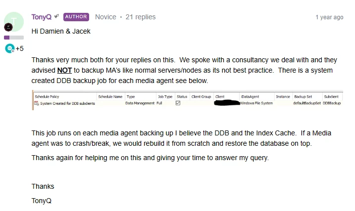

I have found this:
But on one MA i can’t find this subclient. Is it possible to create them?
