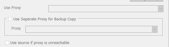

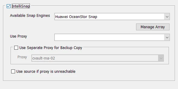

Hi, Is it possible to perform a backup using the Block-based Backup technique with Separate proxy for Backup Copy?

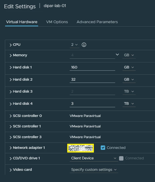

Client is a virtual machine running Oracle Linux (64-bit), VMware Tools version:11269 (Guest Managed)

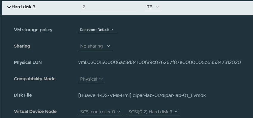

The data is on the “Hard disk 3” mounted on /mnt/data. It’s an RDM disk.
The Block-based Backup technique is working fine.

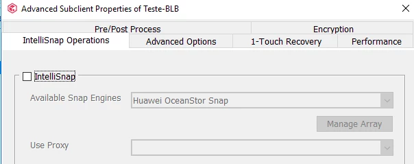

When I check the IntelliSnap option and try to use a Separate proxy for Backup Copy (selecting a virtual machine Linux Media Agent Data Mover), the job completes with errors.
Error Code: [32:392]
Description: Unable to find OS device(s) corresponding to clone(s). Possible reasons could be 1) Improper FC/iSCSI H/W connection between the host and the array 2) The OS didn't find the device corresponding to the clone. : [Unable to find device(s) corresponding to snap(s)/clone(s)]
Source: cvault-ma-09, Process: FileScan

sarvesh, thank you, If I understand you correctly, It’s possible to use a hardware snapshot engine to backup an RDM VMware disk data, that is, a physical storage partition (LUN) from a SAN that is directly mapped to a virtual machine (VM) using a small mapping file, bypassing traditional virtual disks (VMDKs).
In this case, Can we use a virtual MA as Proxy?
I'm asking because I'm thinking of using the same virtual Data Mover MediaAgent from Storage Policy as the Proxy. The virtual MediaAgent that I plan to use as a Proxy is on the same VMware Cluster and I've already checked the permission settings on the storage side. All VMware hosts on this cluster have access to the LUN. The client where LUN resides and the Media Agent that I plan to use as Proxy are on the same VMware Cluster.

sarvesh, yes, this is a POC, I tried it and It didn’t work. Support told us that Block-based Backup with IntelliSnap (hardware snapshot integration) don’t support to use a virtual machine as the proxy for the backup copy phase of a block-based IntelliSnap backup when hardware snapshots are involved and the operation requires direct FC/iSCSI access to the storage array. The error I am seeing ([32:392] Unable to find OS device(s) corresponding to clone(s)) confirms this limitation.
Could you take another look at that?
https://support.commvault.com/Case/Details/251117-809

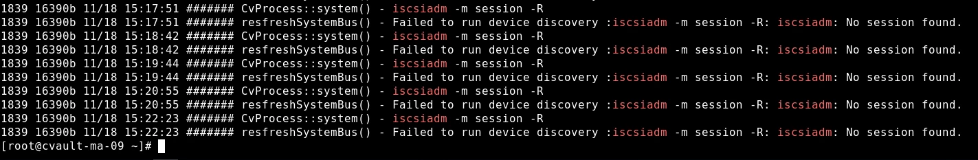

Ok, thank you, It appears to me that Commvault is attempting to use the iSCSI protocol. See the screenshot below. I don't recall seeing anything about this in the documentation, at least not in the section about Block-based Backup with IntelliSnap.
CVMA.log
I also don't remember configuring the MA server as a Host initiator on storage side, but it's there. Maybe Commvault created it. I took the opportunity to give the LUN access to the iSCSI host cvault-ma-09, but the backup still didn't work. It's as if something is missing on the MA server side.

Sarvesh, we have investigated the issue internally and identified the problem as configuration issues on the storage side. I was somewhat disappointed with the documentation, as I wasted time investigating a setup that would not function without first configuring iSCSI on the storage side. This crucial requirement was not clearly noted.
I recommend updating the documentation to explicitly highlight the necessity of iSCSI configuration on the storage device to prevent others from encountering the same delay when trying to select a virtual machine as the proxy and the Backup Copy proxy.
