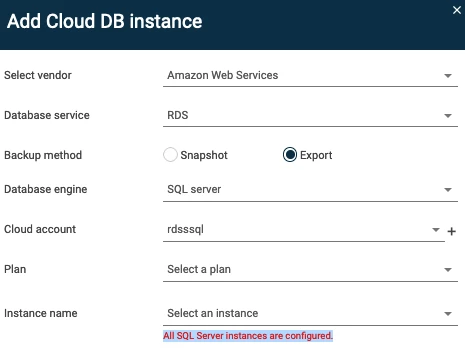

Hi everyone please i need some help, i try to discovery RDS SQL instances but is not occurred.
I have open many cases in support, and they work in issue but they are not finding a solution.
All system requirements are OK, but what's even stranger is that it lists every other technology, just SQL, which doesn't.
The message in cvd.log and the Command Center is: "All SQL Server instances are configured."
i put the screen in attach
We have already exhausted all possibilities for resolving this problem.
Pleeeeasee i need help
best regards for all!!
Sandro

@Sandro Balduzzi
Do you have any ticket #s you can reference so that I may review previous engineers findings?
Please also confirm the feature release / version you are running (e.g. 2022E or 11.28).
I suspect the issue is likely due to some missing permissions on the AWS side preventing us from being able to discover the instance, so would need to check the cvd.log on the Commserev at the time of failure.

Hi @Chris Hollis, tks for answer me.
Yes, i opened case 231226-349
The version is 11.30.74
I was looking at cvd.log in MA, I'll try and analyze it
Forum|alt.badge.img
i'm look this log but not find any error or mention to rds sql
I had another call with support today but they just requested the logs again and are analyzing them.

Hi @Chris Hollis sorry for my late to update this issue
The support team detected a bug, I needed to update my environment to 11.32 (long term) and developed the specific fix and then listed all the rds sql instances
Now we have other problem, the large size of SQL Server databases but we are treating this issue with support
Tks for you attention
Regards,
Sandro
