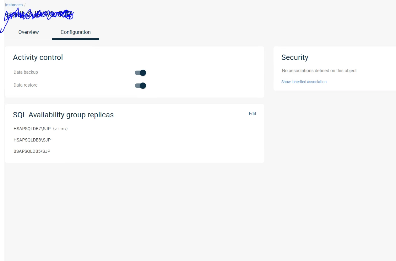

hi, thank you!
I don't have this option “Offload full backup job etc...”
see pic attached on this replies
