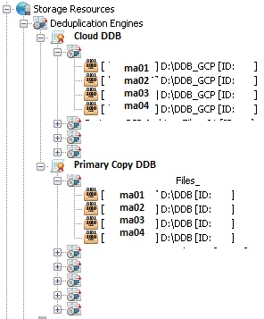

Currently have 4 media agents with 2.5TB local SSD dedicated for DDB. A while back we decided to move to the cloud and thus created a new storage pool (deduplication enable) so we would only move changed blocks from primary to the cloud. The new DDB location for the cloud pool is on the same disk as the existing DDB for on-prem data. At the time, the capacity was ok and so we moved forward.
Trying to make things easier to understand, I am adding the following screenshot;
As seen above all 4 MAs share DDBs for box Primary and Cloud and I am running out of space. We are purchasing additional drives with a higher capacity to address the problem and here is where my questions come in and would appreciate some feedback. I would prefer to avoid running new Fulls as a result of this tasks.

  2. Add the new Larger Drive to Windows, configure as DDB1 and do a Move documented here. I would only move the Primary Copy DDB stores to the new Drive. This would completely separate dudep drives from Primary to GCP however I am not sure I am taking into account everything that is needed for this task. Documentation talks about a workflow related to a move from MA1 to MA2 and I assume that workflow would not be applied to my case.
