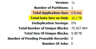

Hello,
In order to recover space, some days ago I deleted all jobs from one Storage Policy Copy, but I don’t see the data has been deleted from the local disk library, and when I check the forecast report there are no pending deletions.
I have run a DDB Space reclaim job with Clean Orphan Data selected, I have waited a day before rechecking again, but there are no changes.
Any ideas on how I can reclaim and recover this space?
(Or if it is a matter of time, how long should I wait? Could I check the delection process status?)
Thanks in advance.

No, the GDSP only has one SP.
How can Total Application Size be 0 and Total Data Size on Disk be greater?

Not sure about that quirk.
Do you have any active jobs writing to that SP\ GDSP?
If you a forecst report for that SP, what does it say about jobs in that SP?
What does view jobs through the SP Copy show you, or better still the GDSP?
