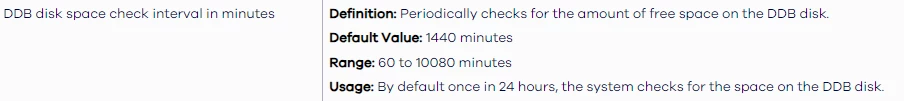

i would like to know the sync time for the hyperscale x hardware status , we have removed network card from nodes but it doesnt reflected in the command center same time , it took around  a day to update , is there any way to get it same time

Hello @Ajal
We run Health Check updates every 30 minutes by default. Unless this setting has been increased, the Command Center should update within 30-60 minutes of any changes.
https://documentation.commvault.com/2023e/expert/media_management_configuration_service_configuration.html
(It does say Space Check, but we do the Health Check during the Space Check so this setting controls the Health Check interval).

Hello @Ajal
Thank you,
Collin

It does say once in 24 hours by default and how are you achiving 30 mints when the range is start from 60 @Collin Harper

Hello @Ajal
Sorry I was mistaken. This value must have been updated from 30 to 60 since last I checked.
Thank you,
