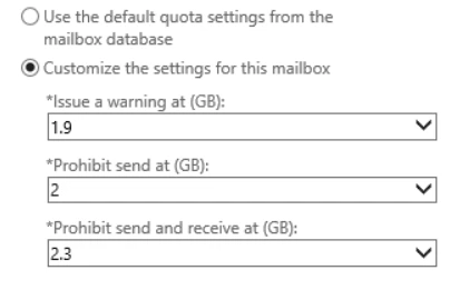

Hello Tim,
Yes, this on prem exchange 2019, with mailbox agent correct.
Customer configured quota limit with 2 GB, something like this but he selects (user the default quota settings from mailbox database. not customize
