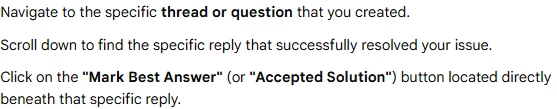

how to mark

Hi ​@Laxman.Puvvalla
You can try below steps :
