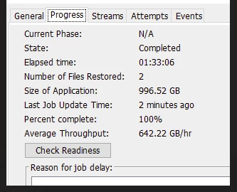

@Sunil. Thanks for suggestion. I have change the data streams to 8 and that make a big difference.
My media agents are HSX nodes (5 of them). I don’t see much impact on those nodes in terms of CPU and mem utilization. Now testing with 10 data streams and monitoring.
We didn’t change the data streams count before as CV mentioned that this may have a negative impact on the backup/restore jobs.
Will keep you guys posting.

After increasing data streams to 10 we have shortened the 8.4TB database restore time from 18 hrs to 8.5.
