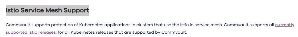

Openshift Servicemesh (istio) is supported from SP32
https://documentation.commvault.com/2023e/essential/system_requirements_for_kubernetes.html#istio-service-mesh-support
On the application group content try to browse the application and check if you are able to see the CRD application

THanks for answer. Yes IT seems COmmvault support it. BUt  My backup completes succesfully without error, I can not see istio apllications in the backup
