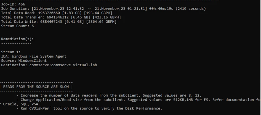

Just to add some additional considerations on this one.
  1. The job in question must have ran for at least 10 minutes in order to generate the log.
  2. Recommendation is to suspend any long running jobs rather than killing them and running the performance analysis tool against them for automated analysis.
  3. If the information is not generated into the analysis log and the job has ran for more than 10 minutes you can run the tool manually as per the below example
