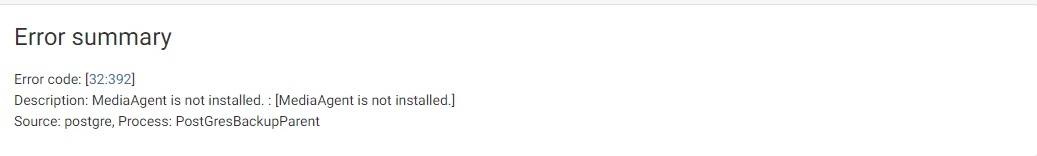

disks are set to lvm on my postgre server.
When I want to take native block level backup I keep getting error
error code: 32:392 media agent not installed

Hi @BillyBoo
MediaAgent package is a required package for performing IntelliSnap/BlockLevel operations even though it’s LVM snap. Can you please install MA package on this Postgres server and try again?

  • April 21, 2024
Thanx @Sunil   your advice fix media agent error.
I also had to change the posgres data path.thank you 👏.
