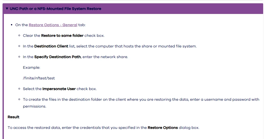

Once the NDMP volume is available as a share, you don’t need to map the drive, you can directly restore to the share location: \\<SERVER/IP>\sharename or “/finite/nftest/test” using the steps in:
https://documentation.commvault.com/v11/expert/restoring_data_using_windows_file_system_agent.html
Note: ensure the MediaAgent used has access to the Filer IP.
OR in CC and select Network Share Path with a Windows Access node for SMB or Linux Access node for NFS.
https://documentation.commvault.com/11.40/essential/performing_file_server_restores.html

The NDMP client itself will not be shown here… It will be a Commvault Client aka as the access node, typically a MediaAgent which has access to the share that you specify in the destination Path.
for example, we have a mediaagent called ROB-MA1 which you're able to access and navigate the share you've created a share from the ”Dell PowerScale appliance” let's call it DELL-NDMP01.
So to issue the restore, the client you would use is ROB-MA1 and the destination would be \\DELL-NDMP01\<someshare>\Restoretest. Ensure you've entered the credentials in Impersonate User. (Refer to the instructions in my reply above).
Hope this helps.
