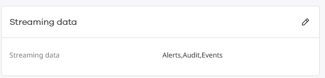

Thanks for the detailed Threat Scan 2.0 capabilities. The analysis covers a wide range of threats, including malware, YARA rules, and encryption detection. However, these findings need to be reviewed by security administrators, and I haven't found a reliable way to forward the relevant results to them.
The SIEM connector appears to forward only Alerts, Audit, and Events, but not the specific Threat Scan findings related to malware, YARA, or encryption.
I also noticed that Threat Scan Groups have an option to configure email notification recipients, but this does not seem to work in my environment.

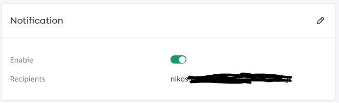

So, what is the recommended way to forward Threat Scan 2.0 (TS2.0) findings to security teams?
Email notifications do not seem to work, and neither does the SIEM integration for these specific findings. Is there another supported integration or recommended approach?
