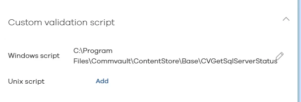

Hi i want to doing  vm validations  with network.
By design, vm validate  works without a valid network.But i need the execute post script after vm deployed to esx .
Is there any way to validate vm with network ?

Unfortunately VM validation is designed to not leverage the network to prevent any kind of collisions with production systems.
If you need to run a script I’d suggest using a custom script as per: https://documentation.commvault.com/2024e/essential/scripts_for_application_validation.html

Hi
script running with manualy. but job doesnt execute script
script always getting error messasges .doesnt execute
 Scheduler Set pending cause [Operation [Script Execution] failed with error [Application validation failed with exitcode [-1] error [Script failed to launch.]] for client

With that in mind, I would recommend raising a support incident to investigate the script execution.
That error message implies that the script couldn’t start at all.
