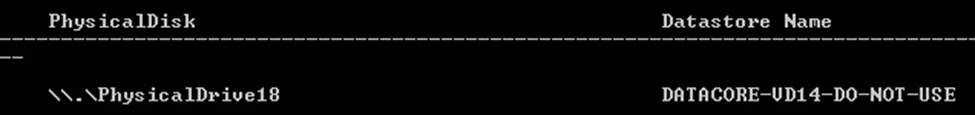

You can use VMFSSANINFO Tool on the VSA Proxy to confirm that the VMFS LUNs are visible:
https://documentation.commvault.com/2023e/expert/113660_vmfssaninfo_tool.html
This is what you should see:
