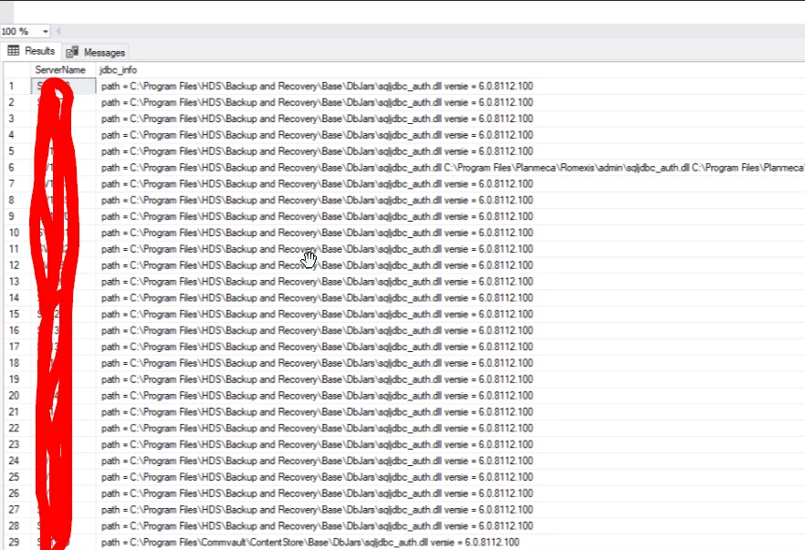

@Pradeep What about clients where sql agent are installed, its usinng sqljbdc_aut.dll (native token) and version is not up to date
On the commserver we are using versie 17 of odbc and not jbdc
