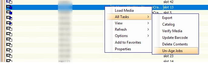

Thanks Damian, I am talking about this option :
Do you know how to extend the retention set on a tape that is not exported yet ? I want to increase the retention before the export.
Thanks
Forum|alt.badge.img+17
Hello @Amin91
It looks like the tape already has jobs within retention so this option will un-age the jobs on the tape that have already aged and let you manually set a new retention for the jobs.
Un-age the Job from Media Level - https://documentation.commvault.com/2023e/expert/un_age_job_from_media_level.html
