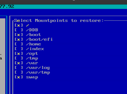

hi Mohamed,
thank you for your reply, hope you are well too.
after restoring the system state, is creating me the client_recovery in the commcell but is greyed out, is has no FS on it. So i know that during the 1 touch, after the step of this 1st reboot, it was supposed to take me to the step in screenshot attached, in order to restore the filesystem. And i do not reach this because of the black screen. My question would be for everyone in this community, did anyone ever used this as a singel method of DR and is working properly? Because we are testing for a long time and having trouble making it work.
Thank you!
