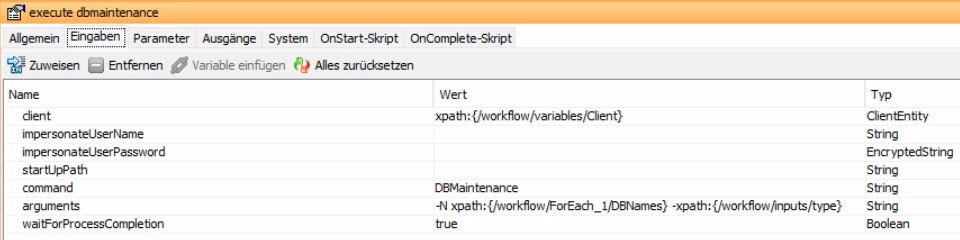

Best answer by Florian Kaiser
hello,
I had the same issue with a customer of mine.
The Issue is that the part ‘-N path….’ does not belong in the Input Field command. It should looking like this.
in later Commvault Versions you have to think about the enhanced security for changes in the workflows.
Enhanced Security for Custom Workflows and Reports
Kind Regards
Florian

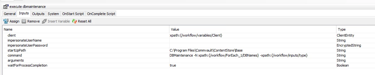

​@Gseibak   Is this correct for the workflow DBmaintenance - execute.   I actually added the startUpPath but not even sure if I needed to.  It still fails.
SNIP:
Forum|alt.badge.img+3
hello,
Kind Regards
Florian

Thanks  ​@Florian Kaiser

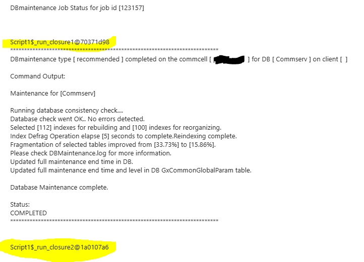

I think Im back to the way it use to be.   But still wondering where this “Script$_run_closure1...” stuff is coming from and why in the email that it auto generates..
This is the email results that Im getting.
SNIP:
Thanks
