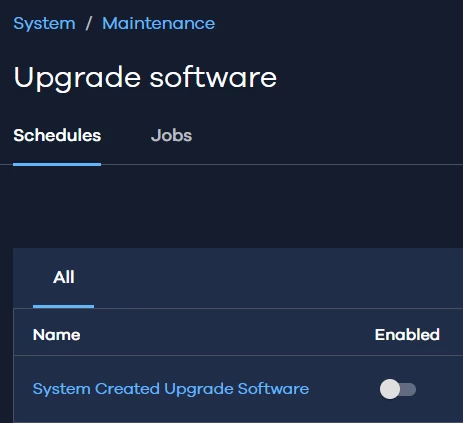

Scott Moseman
Vaulter
Forum|alt.badge.img+23
Are you disabling in Command Center, too?
Thanks,
Scott
Onno van den Berg
Community All Star
Forum|alt.badge.img+24
Thanks,
Scott
If I recall correctly this settings related to the job schedule that is attached this this function underneath. The additional setting disables the function on a different level with the same outcome.
