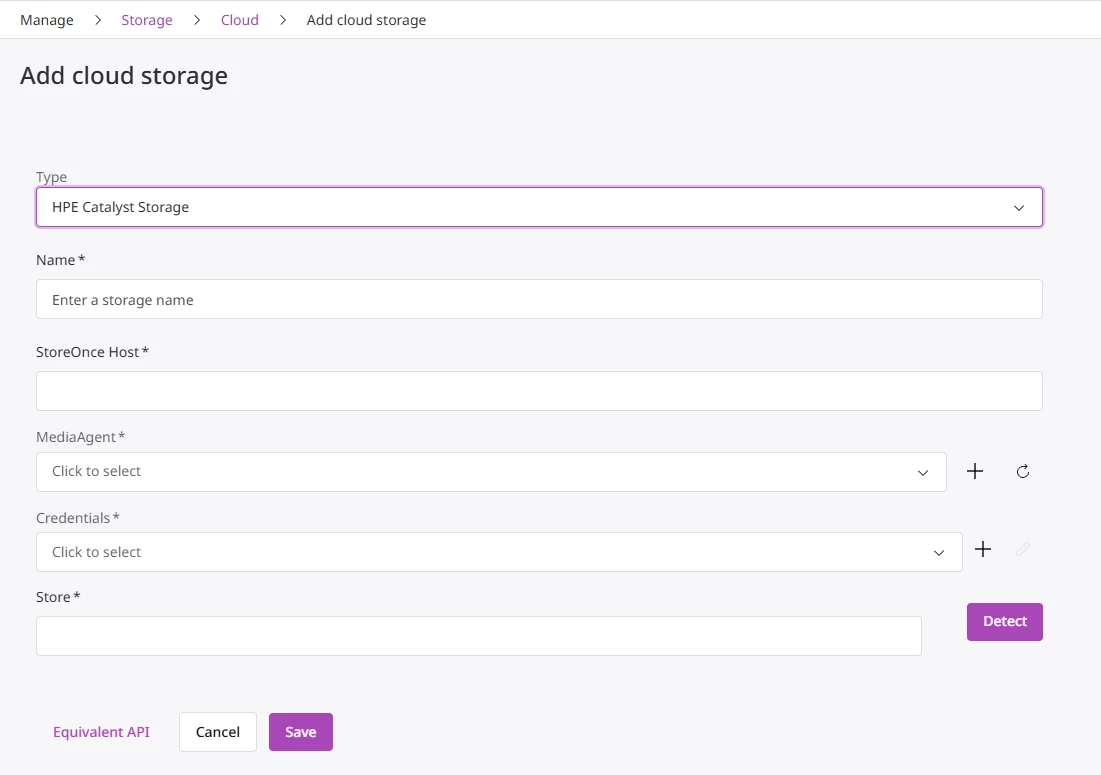

So when defining a HPE Catalyst library, you will associate a VSA or FS subclient with a plan. In 11.44 you can now disable compression at the storage level, in earlier version you have to do that at the primary copy level for each plan/storage policy or at the subclient level.
Plan will be linked with HPE Catalyst library and you can disable compression on the plan in the primary copy or at the storage level in 11.44. At the subclient level you can also disable the compression but it is easier if you do that at each plan you define with a HPE Catalyst library or at the storage level for each Store you define instead per each subclient. Dedupe setting at the subclient level does not affect if the storage is not using CommVault deduplication like with StoreOnce, I think when you define an HPE Catalyst library you cannot select the Commvault dedupe feature:
