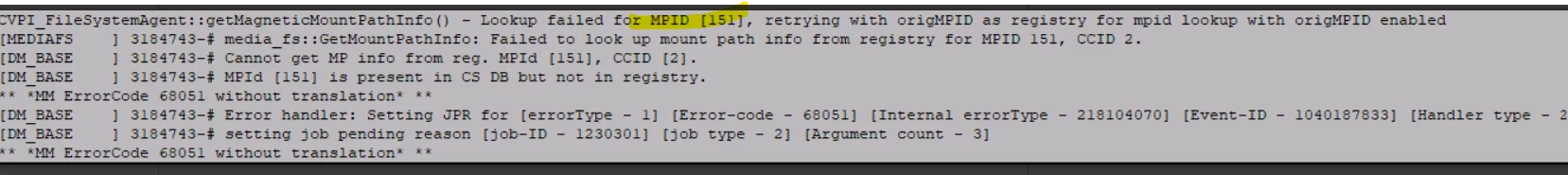

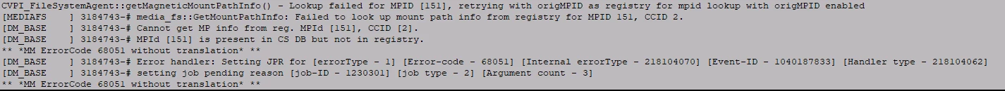

I have the same issue as PrashanktK, I have parse the logs from ScalableDDBVerif, here is the error I have before error code [62:441] :
Could you help me please ?
Best regards,
Gilles

Hi ​@Gilles SCHMIDT,
Here the mount path MPID 151 was not shared with the MA which is performing the READ operation.
Please correct the mount path sharing configuration and then restart the job.
