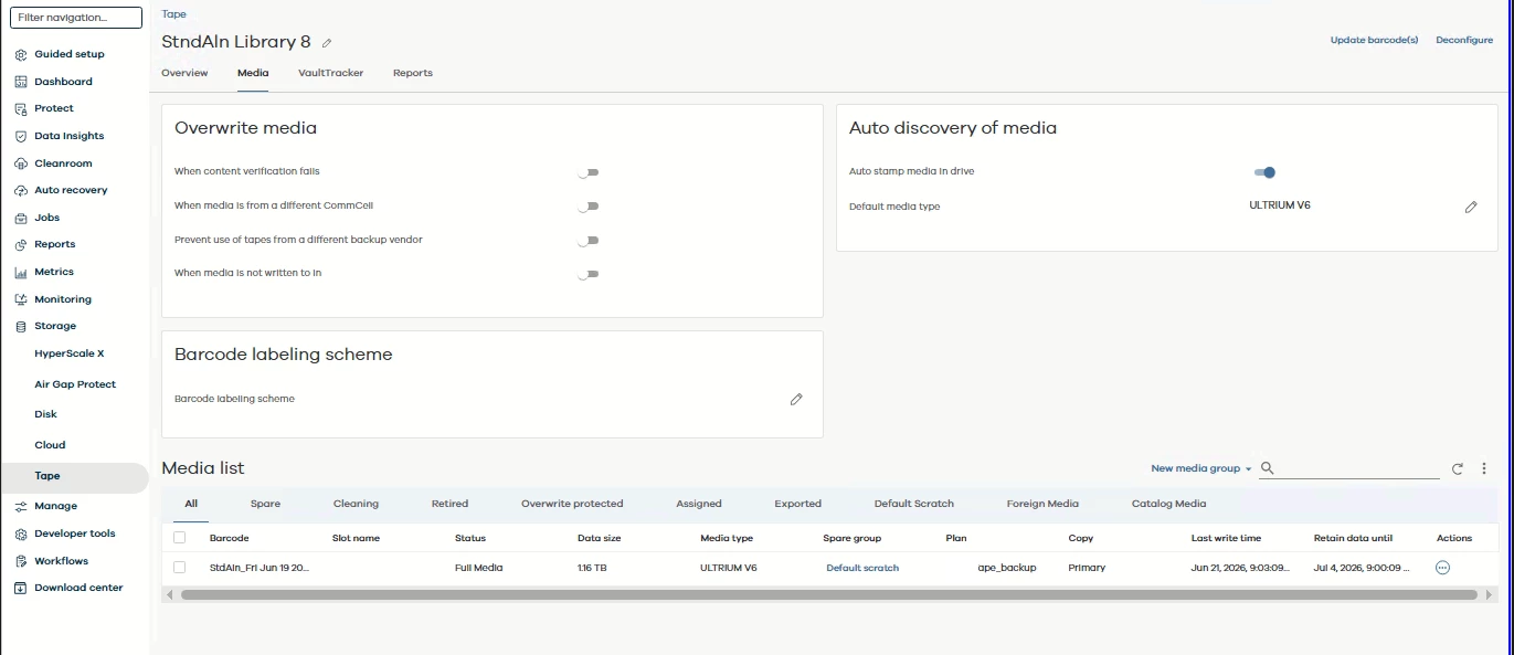

The first backup completes successfully and writes about 1.16 TB of data. However, after the backup finishes, the tape media is usually marked as Unavailable, and sometimes it is marked as Full.
From my understanding, an LTO-6 tape should have a native capacity of around 2.5 TB, so I'm not sure why Commvault considers the tape full after only about 1.16 TB of backup data.

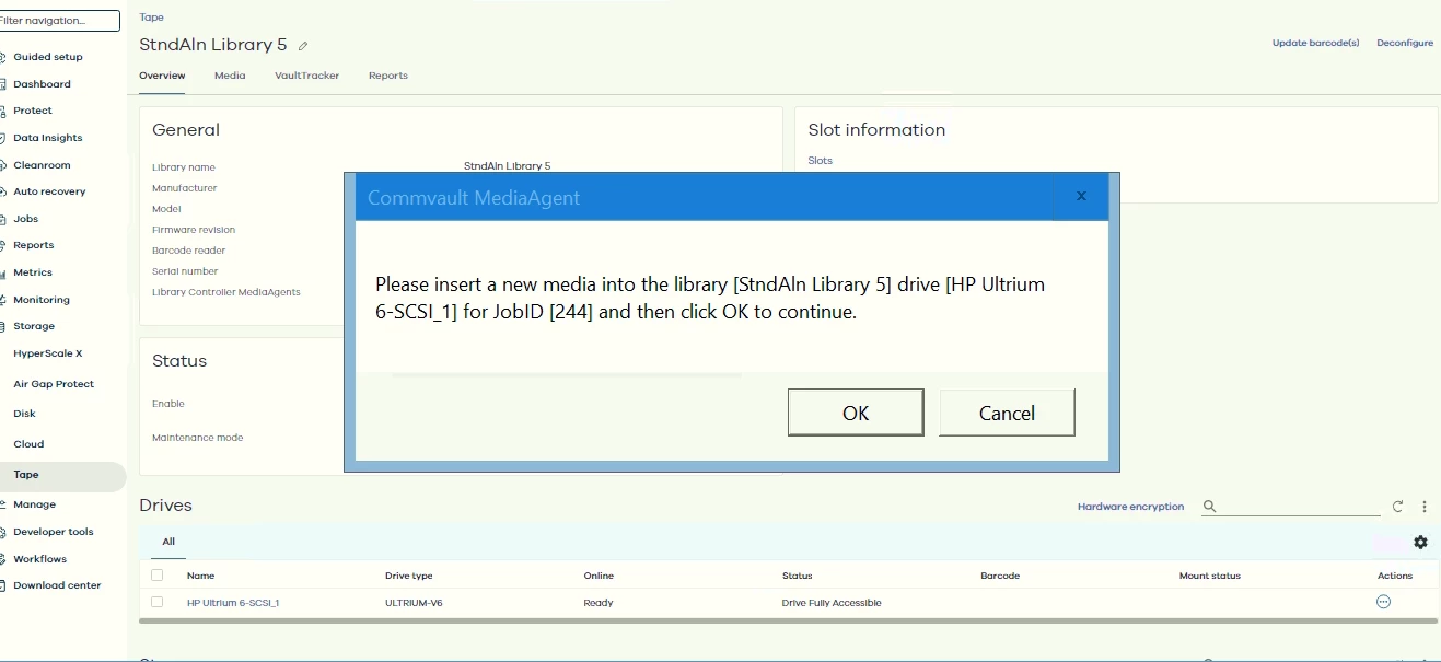

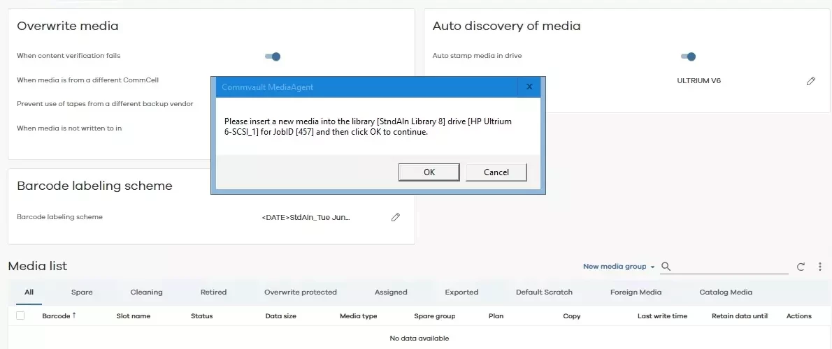

When I start another backup job, Commvault prompts me to insert a new tape instead of continuing to write to the current tape.
I also noticed the following:
    If I power cycle the tape drive, the tape appears as Active again in the Media tab.
    However, the backup still cannot continue because Commvault displays an "Insert New Media" alert.
    I searched for the Start New Media option mentioned in some documentation, but I cannot find it in the Web Console.

I couldn't find the option to mark the media as full in the Web UI of the Commvault version I'm using.
Regarding the storage policies/plans, this tape is currently used as the primary media for the tape backup plan that I created. Previously, the same tape drive was used by other backup plans for testing with test files. However, those test data have been deleted, and the tapes were marked as Reuse in the tape media.
I also tried deleting the tape data that was showing 1.16 TB and ran the backup again. However, after the job completed, the tape was marked as Full again at 1.16 TB.
So yes, the backup is performed directly to tape. The tape was previously used by other storage policies/plans, but it is now assigned to only one backup plan.
Could this previous usage still be preventing the tape from being written to, or is there another setting that could be causing the tape to be marked as full at 1.16 TB?
