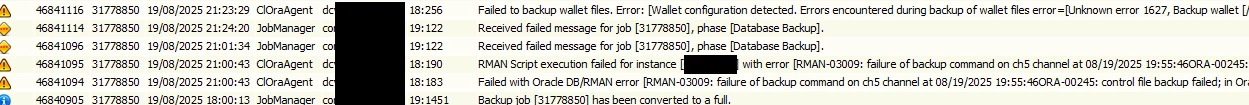

Events from an incremental job
I’ve thought that maybe it was something happening on the DB itself but from what I gather the job gets turned to full even before it does anything on the Oracle side.
